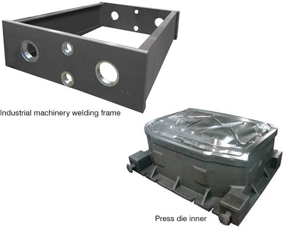

By taking advantage of the easy to install, space-saving performance, a variety of industrial and transportation equipment machine shops are benefiting from effective parts applications.

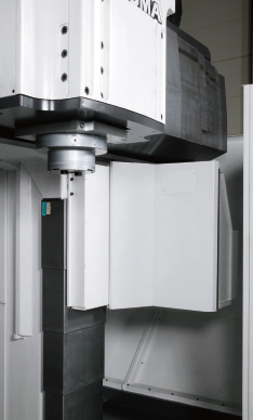

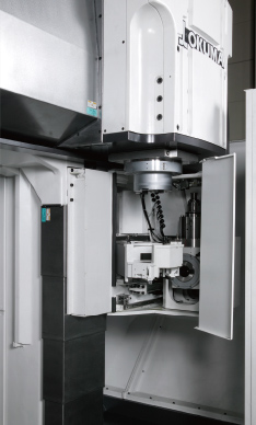

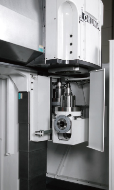

Compact AAC (Auto Attachment head Changer)
Auto load/unload and ATC to attachment heads enable completely automatic multi-face machining. Column right side mounted AAC also allows fully automated changing of extension and 90° angular heads.

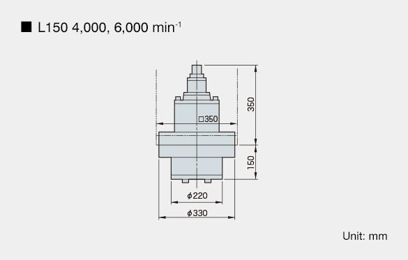

Extension heads
- Machining capacity:
- 710 cm3/min
(spindle bearing ID: ø100 L150)
ø160 mm 8-blade face mill
- Cutting feed rate:
- 221 m/min
- Infeed × cutting width:
- 5 × 112 mm
- Feed rate:
- 1,267 mm/min (0.36 mm/blade)
- Z-axis protrusion:
- 800 mm

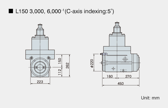

90° angular head
- 600 cm3/min
- 221 m/min
- 5 × 112 mm
- Feed rate:
- 1,071 mm/min (0.30 mm/blade)
- 800 mm
