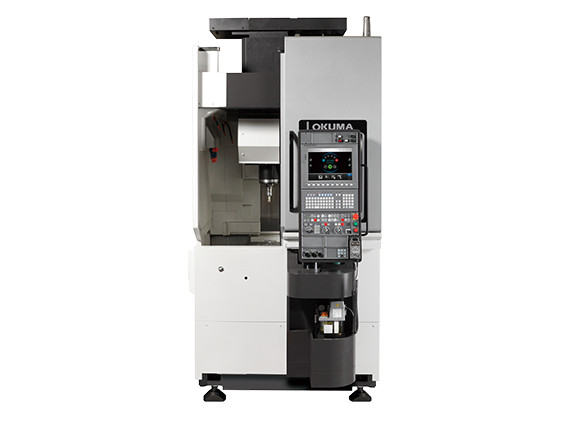

- A single machine
A super compact and easy-to-use smart machine

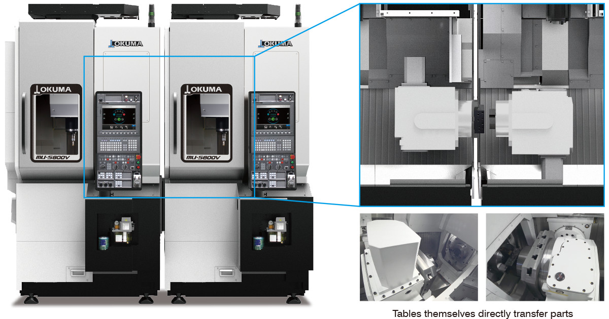

- Connecting 2 machines
The tables collaborate in an innovative Work Handoff System,
for smart production line system applications

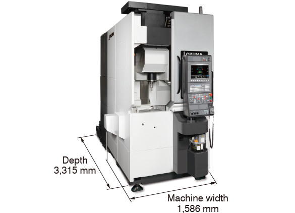

- A wide range multiside application with one, smart, compact machine

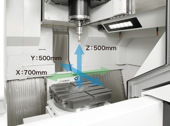

- Compact but with wide machining area
Built with a long X-axis travel of 700 mm in a machine width of just 1,586 mm.

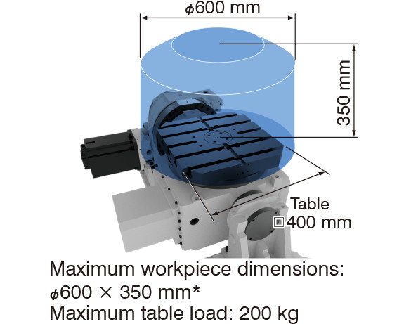

In addition, it is possible to load workpieces up to 600 mm in diameter on the 400 mm square table.
As a 5-axis vertical, Okuma has achieved best-in-class floor space productivity.
- Loadable workpiece size
* When transferring workpieces between machines, the maximum workpiece dimensions will differ.

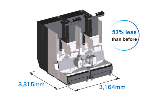

- Space-saving machine

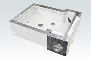

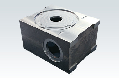

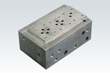

- Ideal for multi-sided indexing of castings and aluminum workpieces
- Multi-sided machining is possible with one chucking, making it possible to reduce setup time.
Also, work mounting errors between operations are eliminated, and high machining accuracy can be maintained. -
Gearbox case -
Manifold -
Cam box

The MU-S600V features a built-in Work Handoff System, so the tables of machines connected to each other can transfer parts, eliminating the need for transfer equipment between machines. -

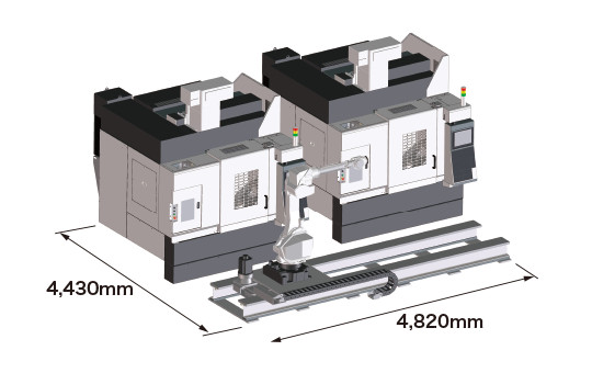

- Conventional production line layouts can now be redesigned, to dramatically reduce the floor space of the automated systems.
Conventional production line: 22.4 m2(Two 5-axis VMCs + traveling robot) -
Smart production line: 10.5 m2(Two MU-S600Vs)

| Machine size (W × D × H) |
mm(in) | 1,586 × 3,315 × 2,994 (62.44 × 130.51 × 117.87) |
