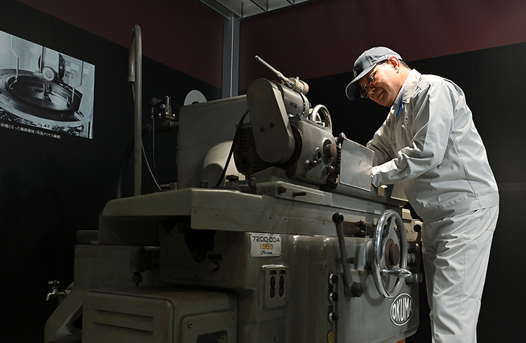

A request for repair of a special specifications GPB cylindrical grinder delivered to a customer more than 50 years ago had been brought to Mr. Kawamura one day. That machine is now displayed as Mechanical Engineering Heritage in the Okuma Memorial Gallery. When he disassembled and inspected it, he found that the unit had suffered serious damage, including seizing, due to poor maintenance, and the majority of its parts needed to be replaced. However, Mr. Kawamura concluded that it could not be repaired because there were no parts in stock or drawings for the machine and because it would take more than a year to complete the repairs even if he undertook them.
But the customer did not give up, saying, "This machine is used for critical machining that cannot be handled by other machines. I would like you to fix it no matter how long it takes or how much it costs." Ultimately, Mr. Kawamura manufactured all the parts for it from scratch, and with the full cooperation of the manufacturing department, he revived the machine in a year and a half, pouring all his knowledge, experience, and skills into it. The customer was extremely impressed, and Mr. Kawamura himself was filled with joy and a sense of accomplishment.
