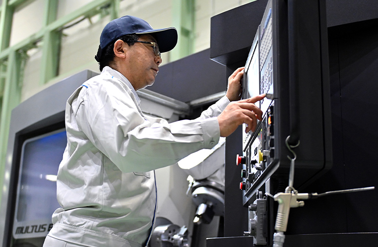

In November 2012, Okuma received some delightful news. Isao Oyabu, a skilled NC lathe worker who had handled an array of difficult machining and been involved in delivery, installation, trial run, and operation guidance for machines both in Japan and overseas, was selected as a Contemporary Master Craftsman, the fifth case at Okuma. He was also the youngest person (at 50 years old) in history (at the time) to be selected in the field of numerical control metal machining.
He was selected because of his outstanding skills in machining slender shafts and thin-walled shapes, which are considered the most difficult tasks in lathe machining, including his ability to achieve a dimensional accuracy of Φ0.05 mm in machining slender shafts with a diameter of 7 mm and length of 150 mm and a roundness of 30 μm or less for thin workpieces with a diameter of 100 mm and wall thickness of 1.5 mm. He also made the most of his skills and contributed to solving problems for customers, such as improving machining accuracies and reducing cycle times through test machining before the delivery of NC lathes, as well as to product machining and guidance after delivery. In addition, he was also highly regarded for his dedication to the development of skilled workers, serving as a Central Trade Skill Test Commissioner of the Japan Vocational Ability Development Association as well as an overseas training instructor.
