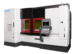

MU-6300V LASER EX

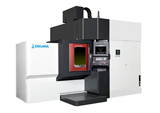

MULTUS U3000 LASER EX
