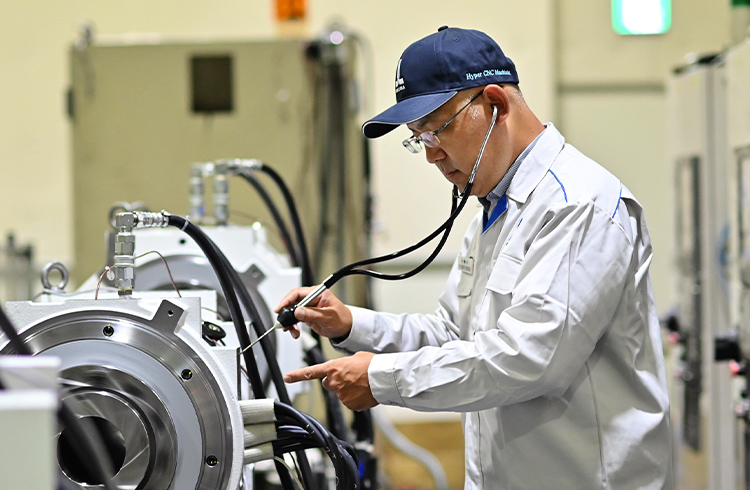

The heart of a machine tool is the main unit, including the headstock, turret, and tailstock. At assembly sites, you'll hear numbers like 1, 3, and 5 flying about. These are numeric values such as parts accuracies, assembly accuracies, or tightening margins for fitting work in which parts are fit together, with the units all in micrometers (1 μm = 1/1000 mm). Here, this is standard.
Takashi Tozaki, a leading expert on unit assembly for lathes and multitasking machines, says, "Even if parts are machined as designed, errors of several micrometers develop during the assembly stage. Making fine adjustments for these errors and delivering the specified performance is our job in the unit assembly process. For this reason, we frequently use measuring instruments in machine shops and complete the process while constantly checking these numerical values. The highest assembly accuracy is pursued for every machine, with the same rigor for both high-end and popular models."
For vibration, an indicator of the stability of spindle rotation, a sensor is mounted to the spindle support body to carefully measure frequencies that are inaudible to the human ear. If an abnormal frequency is detected, the source (the balls, rollers, raceway, or other components inside a bearing) is identified and addressed.
In the past, expert engineers used to listen to the sound of spindle rotation and judge whether it was acceptable. This technique is still used today, and a stethoscope is sometimes applied to a machine to diagnose the sound of rotation. In this way, quality is built in at Okuma through a fusion of the latest measuring instruments and skills based on fine honing of the five senses.
