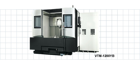

High efficiency production of large parts 5-Axis Vertical Multitasking Machines VTM-1200YB / VTM-2000YB
Watch the videos
VTM-1200YB
VTM-1200YB
From turning to angled surface machining, our VTMs handle vertical, horizontal, and angular applications efficiently in one operation.
