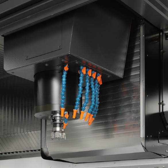

Delivering longer unattended operations
Large amounts of aluminum chips also cleanly removed
  • Wide in-machine chip conveyor
  • Crossrail shower system (Optional)
  • In-machine vertical covers prevent chip accumulation
Wide in-machine hinged conveyors surround the table.Large chip volumes discharged smoothly
Crossrail shower system (Optional) removes chips from the workpiece and table
